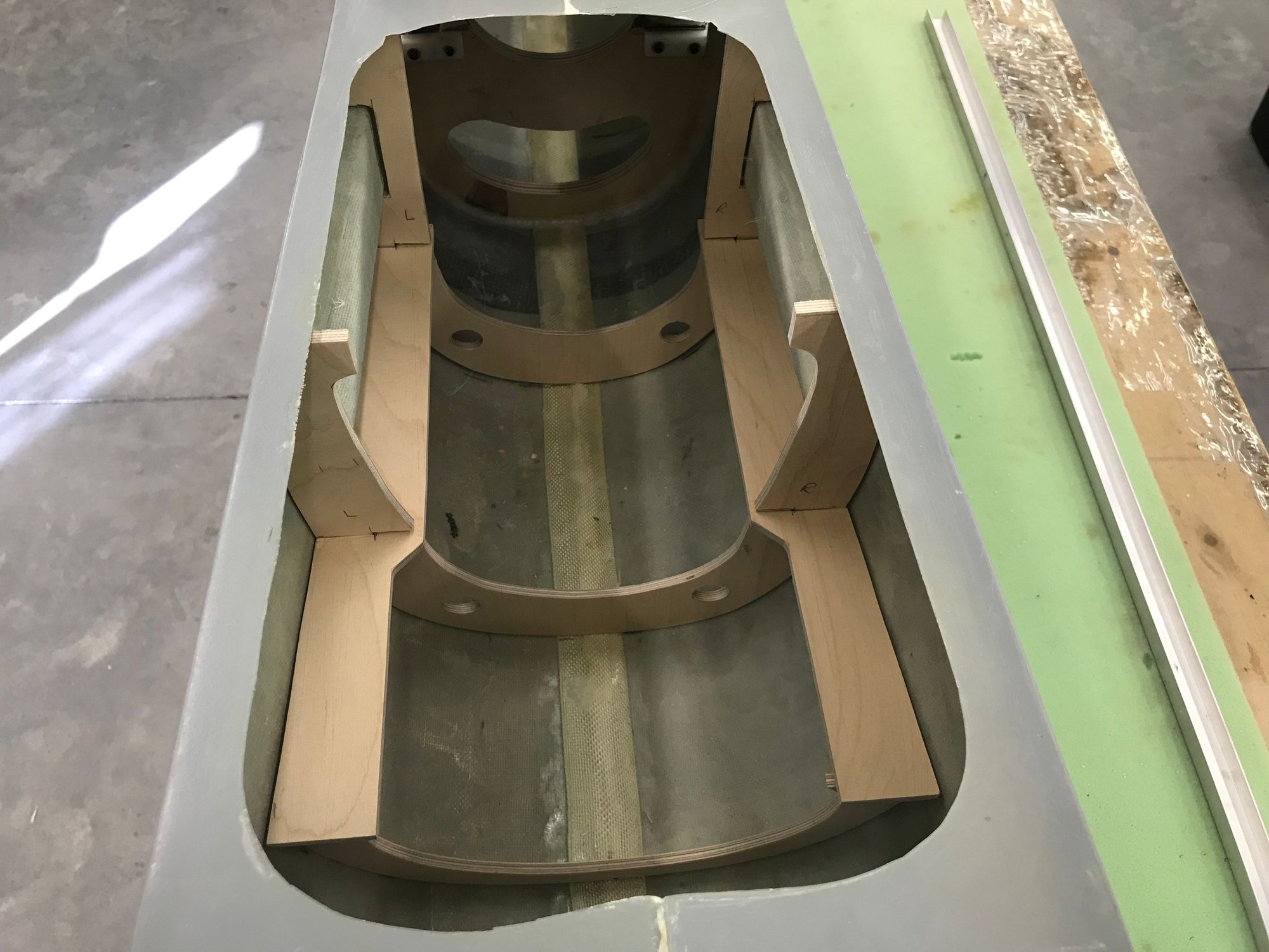

Cutting holes for servo wires in top of fuse
I was able to use the drill and 1/2" forstner bit for all holes except the front former. It was not easy to get drill and my hands inside to make the holes.
Holes in vertical fin former for rudder and drag chute release servos. The servo wires will go forward on the top edges of the fuse.
Holes in turbine formers and wing spar former.
Corner gussets cut for tank front former
Grinder used to make the cuts in tank former and gussets glued in to hold wires and strengthen the former corners. Wires will drop to bottom to go under cockpit from here.
