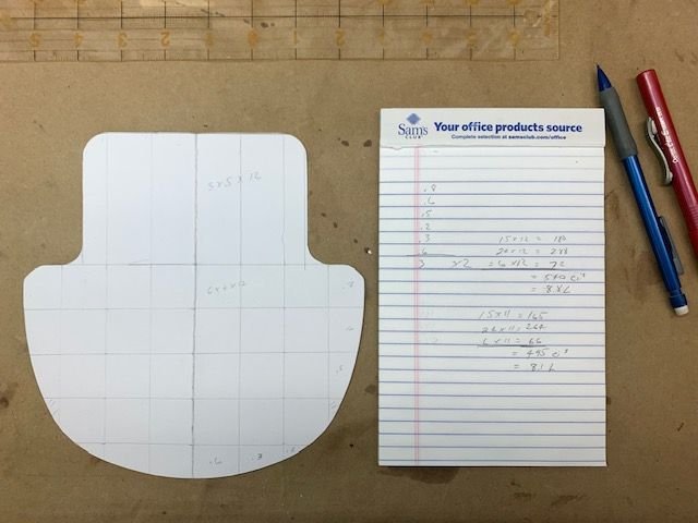

#551
My Feedback: (20)
Tank volume calculation and air duct planning
I estimated the square inches on the template just by eyeballing the squares and estimated between 8.8 and 8.1 liters with out taper in the rear. If the taper shape reduces volume by 20% I will still have over 6.5 liters which is plenty. My Havoc has 6.2 and BVM F-16 has 6.8, both are plenty.
I took the K-320 out of the F-16 and installed here to estimate the air flow path and depth of the tank at the rear former.
I estimate I can use half the distance from the bottom of the fuse to the top of the rear of the tank and still have plenty of air flow to the turbine below the spar. AIr can also flow over the top of the spar to the turbine.

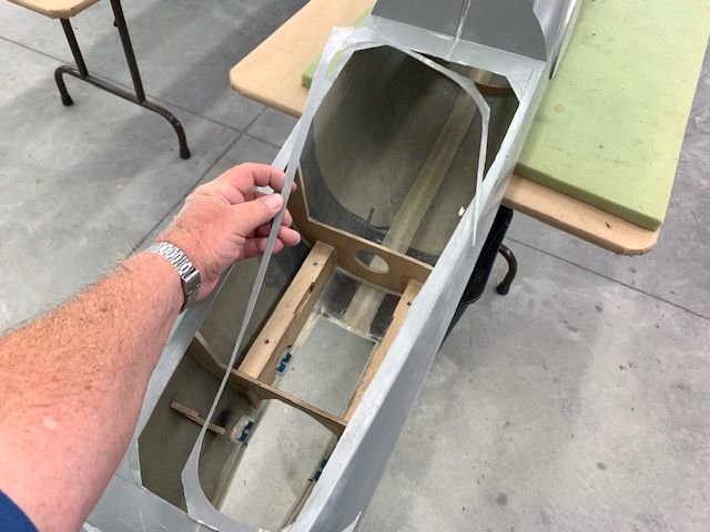

Enlarging cockpit opening
I measured and plotted a larger cockpit opening to get the tank through the hole
Dremel cutting wheel used to make rough cuts
Cut piece removed
Corners rounded and sanded

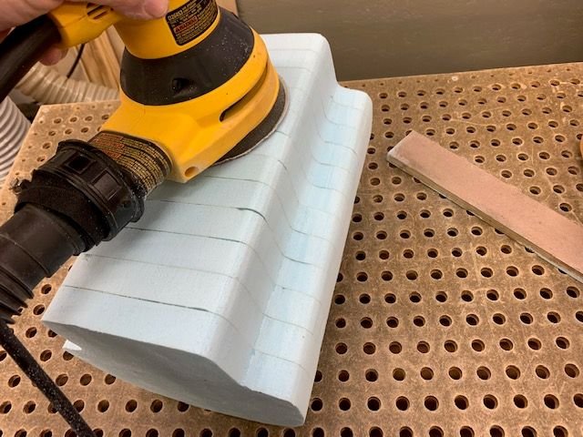

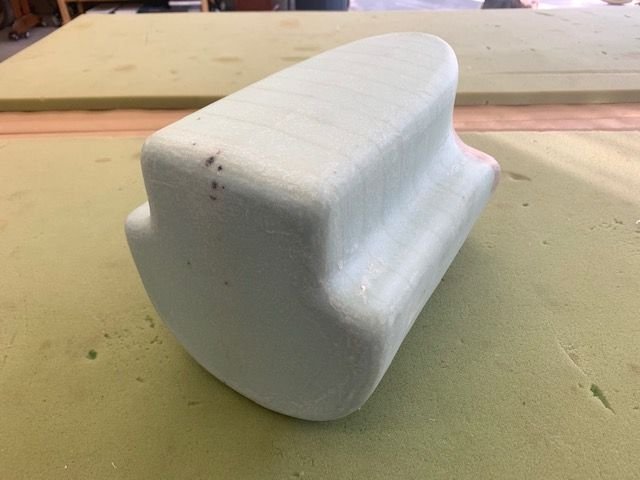

#553
My Feedback: (20)
Making the tank plug

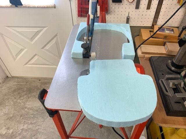

I had some old 1" blue foam left over from my Sabre XLT project so used it for the tank plug blanks
Foam scored with knife and snapped off
12 8" x 8" squares cut
I added a half inch height to the lower shoulder on the template to make use of the space available. I caculated about .2 L increase in volume for that. Then the patterns were traced on the foam blanks
Ready for cutting
The scroll saw was faster than making templates and using a hot wire cutter. Low blade speed was easier to control and worked best. One down and 11 to go!
Cuts all done.
I used 5 min epoxy mixed right on the foam to bond the templates together
Each layer was aligned and squared up then weighted.
All done, ready to sand.
Sanding done on down draft table to control dust
1" dowel and 80 grit in inside curves
Rough sanding done with electric sander
Bar sander smoothed out straight edges
Finished with 180 grit sanding sponge. Ready for rear end shaping.

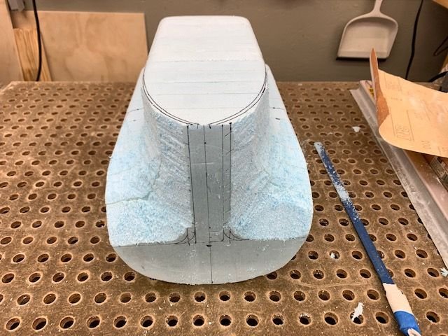

#554
My Feedback: (20)
Shaping rear of tank plug
Plug fits through cockpit hole now
View from the front. Tank plug fits between wing air intakes and will be mounted slightly above the fuse bottom. Tank will be secured in place by a single Velcro One Wrap strap in the center.
View from the rear. Tank plug covers the hole in the rear former so tank has to be tapered to allow air to enter below the aluminum spar.
Bottom of the turbine is about 1/2 distance up from the fuse bottom plotted here by the dowel on the foam.
Taper needs to start at the tank mid point in the air intake
Top view. These plots were generated by multiple iterations of TLAR (That Looks About Right) analysis of aerodymanics and high end CAD (Come Along Design where the design comes along as I draw it) computations. The concept is if I were an air molecule could I follow this line? I think so.
Side view
Taper plotted on top and sides of tank. Foam to be removed in hashed areas
Back to the down draft table with a hack saw blade
Rough cuts done
80 grit on 1" dowel completed the remaining shaping
Smoothed out with 180 sanding sponge ready for test fit

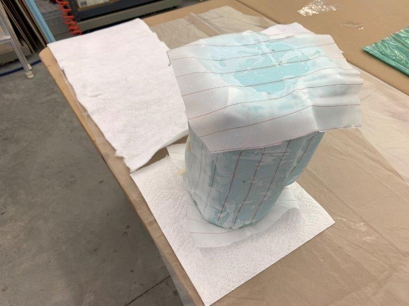

#562

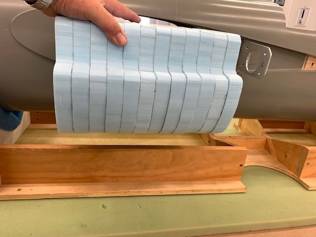

My Feedback: (20)
Glass Prep
Tank plug ready for glassing
I sanded more taper on the draft angles on surfaces to assist in part removal form plug
Also a little more taper in the rear to open up air channels
Measuring for glass cutting
Cutting glass with rotary cutter
Glass end pieces cut
Peel ply cut
Breather cloth cut
Peel ply cut
Breather cloth cut

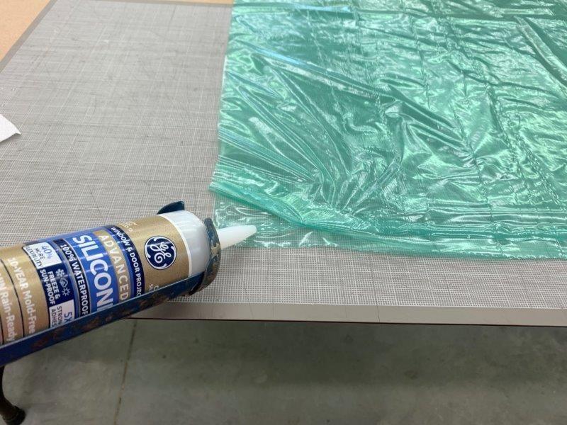

#563
My Feedback: (20)
Bag and layup prep
Vacuum bag prepped using silicon caulk to seal edges
Bag edges folded over and taped with packing tape
Vacuum nipple inserted and secured to top layer of bag film
Bag and glass cuttings ready
Epoxy mixing area ready

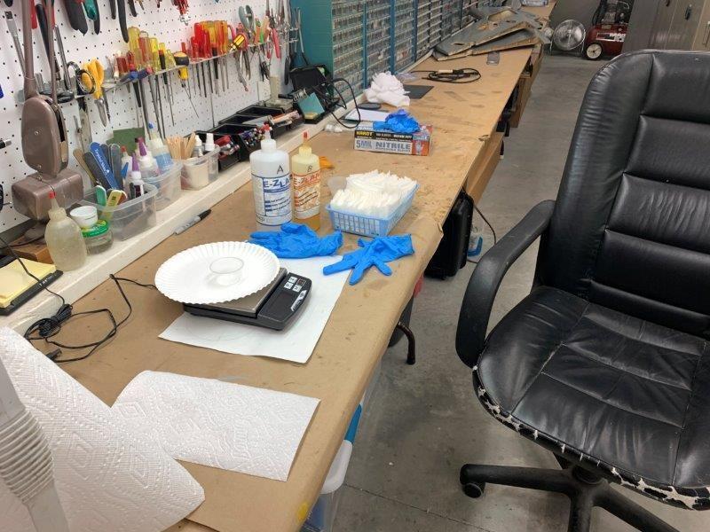

Work table covered with plastic and ready. Every time I get ready to use laminating epoxy I feel like I'm prepping for a disaster. I don't have much experience doing composites so I always have a fear of it all going wrong. So here we go.

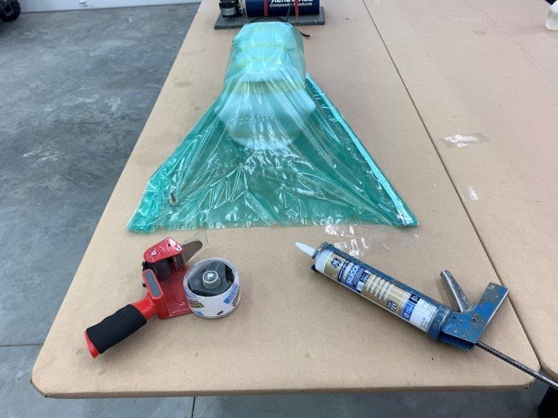

#564
My Feedback: (20)

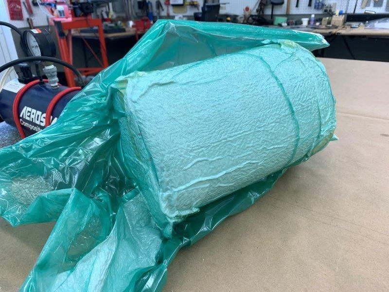

Glassing and bagging
First layer of glass applied, 2 to go
All three layers applied ready for peel ply
Peel ply applied. I never used it before so I really did not know how to do it so I just stuck it on and overlapped ends
Breather cloth applied and taped in place. Ready to place plug in vacuum bag.
Open end of bag sealed with silicone caulk and tape. I forgot to put the bleeder cloth run from the plug to the air fitting so I had to pull the bag open again and then reseal. That got messy with the caulk.
Pump turned on and air getting sucked out.
AIr sucked out to 7" hg and holding. I was elated. No leaks.
Bottom side sucked up pretty good.
Pressure holding good. After about 5 minutes pressure would drop to 5 and pump would run for about 2-3 seconds and push it back to 7 and repeat. Seems to be working ok. Left it for the next day.

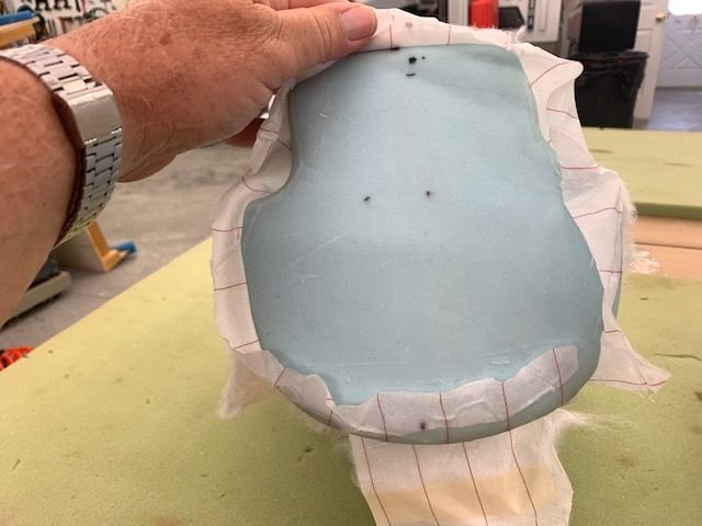

Well here is the disaster. I disconnected the pump and opened the bag. I found the breather cloth and peel ply were completely bonded to the plug. I could not find a way to get it off. After about 30 mins I discovered I could pull small parts off with a pair of pliers.
After about 2 hours I finally got to where I could get some big pieces off. Clearly I did something wrong. I had considered trashing the whole thing and starting over but I finally made some progress.
Finally got to the big piece and it came off easier.
After some sanding and inspection I discovered I had no draft angle at all on the rear shoulders so I sanded through the glass into the foam and reshaped the corner. I used West 205 wtth the red tint to make a quick repair with two layers of glass. After discussing the plug prep with Paul I plan to add tow more layers of glass to give a very strong surface on the plug. Hopefully this will make it less likely to damage the plug when removing the tank halves from the plug. Rookie mistakes again.

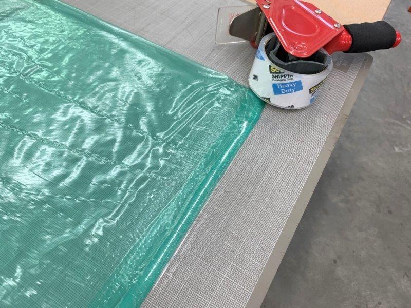

#567
My Feedback: (20)
Second glass layups on tank plug
I took Thomas's recommendation and made some perforated release film. I studied up on the stuff and how to use it and saw some photos of it. I made some homemade film by hacking up some plastic film on the cutting board using the lines as a rough guide and making "dotted cut lines" on the film perpendicular to each other.
My cut pattern shown here against the black trash can.
I did 3 more layers as before and then added peel ply, perforated release film, bleeder cloth and stuffed it in the same bag as before.
WOW! What a difference a little knowledge makes. Thanks Thomas for the tip. This time the breather cloth came off easy.
The release film pulled right off no problem
The peel ply was a little tougher but no real problem. All off in about 5 min vs 2 hours as before. Plug ready for sanding and body work. Thanks again!
Gary
Gary
#568
My Feedback: (20)
I will make a left and right tank half off the male plug after I get the body work done and it is finished and waxed.
I'm looking for recommendations for what glass weights and how many layers would be needed to make a sturdy tank. The size is about 8" x 8" x 12" and capacity about 7-8 liters. Its a large tank so I'm asking what weights and layers you experienced composite guys would use.
Gary

#570
Join Date: Jan 2004
Location: Mt. Vernon, IL
Posts: 491
With that shape I would use 4 or 5 layers of 4 oz cloth lot easier to get it to lay down in those compound curves. You will most likely have to do the flat end with separate pieces to get it to fit nicely in the corners. Also a couple of extra layers wherever you plan on putting the tank fittings. I would also offset any fittings where they do not go through a seam.
#571
My Feedback: (23)
I would probly do 2 layers of
3.16oz style 220
2 layers of
5.8oz style 3733
following my a final layer of the style 220.
both of those fabrica are very easy to work with, conform will and are fairly inexpensive from www.thayercraft.com
3.16oz style 220
2 layers of
5.8oz style 3733

Plug primed, filled, sanded
Plug got first coat of white KlassKote epoxy primer for a base coat
Wet sanded, dings filled with glazing putty and sanded again
2nd and 3rd coats of 2K auto primer wet sanded and filled between coats.
